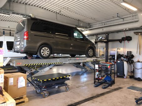

I exactly had similar problems while on my holidays in Norway, now in June 2022, above arctic circle, from Belgium(my home country). Few days before my trip started my MP recovered from a crushed front due to a frontal crash with a deer. A week after recovery we started our 8000km round trip vacation.
I am a new member here and just noticed your post. I went to nearest available MB garage in Norway and they repaired/changed my ABS sensor( now I realize the initial repairing MB garage in Belgium forgot to update /upgrade software) then I paid around 600 euro immediately to the MB dealer in Norway as total cost; actually I paid now extra after the 2nd repair. I have also strange skreeking noise and still unpredictable ABS warnings, as Nowegian MB dealer above arctic circle only keep us mobile during our vacation.

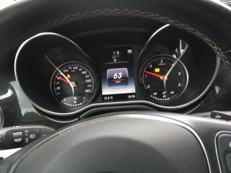

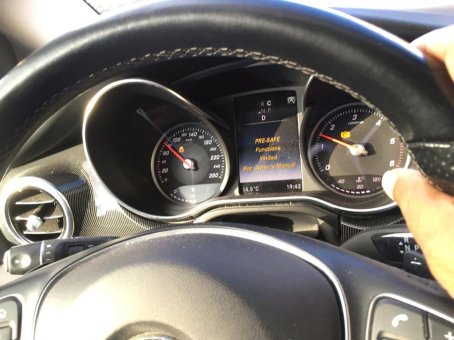

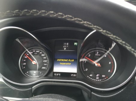

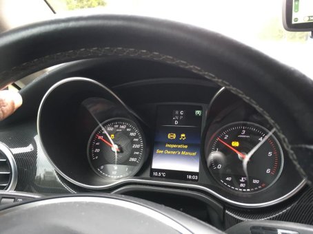

I am attaching all the similar photos and the video.

Nilanjan
Furthermore here is the video / audio of skreeking sound . Not a brake issue… does any one have experience with this issue?

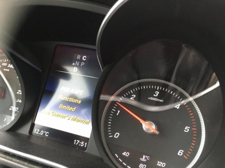

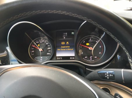

I'll start another thread for the tailgate release, as this may have a wider audience. It was only the tailgate that would not open at all, which was particularly inconvenient as we have two large storage containers beneath the bed extension. The sliding door could be opened (with effort as there was no motor assist), the upper tailgate door would open (access to top of bed extension), and both front doors operated normally. The doors unlocked, so this system does not seem to get a speed signal from the ABS computer. Picture of dash warning message below:
Thanks, Mat.
