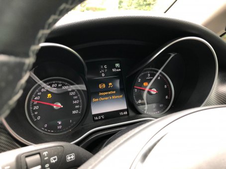

During a recent trip I was travelling on cruise control on the motorway when the speed started varying slightly, then the ABS and traction control lights came on, cruise control disengaged, and a message warned me that some of the safety functions wouldn't work. The satnav also seemed to get very confused, and couldn't tell which direction we were going in. There was no way of clearing the message off the dash information screen. We weren't far from our overnight, so just carried on.

It seems that the 'software update' has not fixed the issue, inconveniently while we're away on holiday in Ireland. Same symptoms, ABS and Traction control lights, no cruise control, inaccurate satnav, and no powered doors (tailgate inoperative). Took it to a local MB dealer and they say it's an ABS sensor fault, so will get it fixed over here, and hopefully claim back on the extended warranty when back in the UK.
The ABS sensor fault ties in pretty well with the loss of traction control, cruise and ABS, but not the powered door and tailgate issue. I'll email MB to see if this is expected behaviour.

Update 3:
The ABS and ESC lights reset after a short drive, and door function returned to normal. Fortunately we didn't need to travel around (which would risk triggering the fault again), so had several days of normal function.
As of yesterday I have had two (front) ABS sensors replaced by the nearest dealership (Collooney, Ireland), no warning lights showing after a short drive, and both side door and tailgate are fully operational. This came in at 750 euro (100 euro diagnostic, 180 euro per sensor, plus labour), which I have been told by the extended warranty people will be recovered for me by my local dealer when I get back home (watch this space!)..
I asked the dealer why the doors didn't open when the ABS/ESC was in fault, and they didn't know. They said they'd had another vehicle in (not a MP) with the same issue, which was fixed in the same manner. I'm trying to get details from MB UK, but just getting standard responses telling me to contact my local dealer. One theory I have is that the door controller looks to the ABS wheel speed sensors to tell if the car is moving, so if there's no data from the ABS unit the doors won't operate the doors from a safety perspective. Might also explain why the SATNAV also becomes very inaccurate whilst the ABS/ESC lights are on.

I've heard back from MBUK customer services, who spoke to my local dealer about this issue. The response:
They (the dealer) are confident in their diagnosis that the ABS Sensor fault would stop the doors form working. As this is a safety feature, the vehicle system will rely on a speed signal which will confirm the vehicle is stationary prior to allowing the door to open.
The Retailer further confirm this is not a known common issue and there is no Recall action issued for this by the Manufacturer.
I am not entirely happy with this. Whilst I understand that the door computer needs to know if the vehicle is moving or not, I don't see why it would still reference the ABS computer for a vehicle speed once the engine has been switched off, and the vehicle is in park. I've responded with concerns that this issue would prevent access to the gas cylinder, as I think it would be very difficult to access the cylinder without opening the tailgate, so I'll see what they say. The workaround might be to leave the car for a while, then go for a short drive to hope the sensor fault clears, which would only work if it was an intermittent fault.
