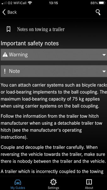

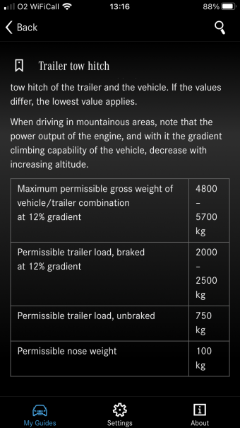

I got the two attached nose weights:
75kg when using a carrier system and I think 100kg when towing a trailer.
And the following braked trailer weights:
Permissible weights of 2000kg & 2500kg which as you mentioned is probably to do with the factory fit tow system in comparison to an aftermarket tow ball.
I have not yet been able to find the GVW of the Marco Polo camper to do the GVW/tow capacity calculation as yet.
View attachment 1579View attachment 1580
GVW of 3100kg + 2500kg fits within the max permissible of 5700kg so all makes sense, thanksHi GT,
Thanks for that, it confirms the nose weight figure I found of 100 kg to be correct.
The online brochure shows the kerb weight to be 2487 kg and the gross vehicle weight 3100 kg.
