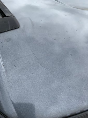

Hello Friends,As Carol has pointed out in her profile post, we have discovered tiny blisters on the roof of our MP. Has anyone else got the same? Anyone been to MB about it?
We will talk to MB and let you know what they say. FYI our MP is 2018 model.

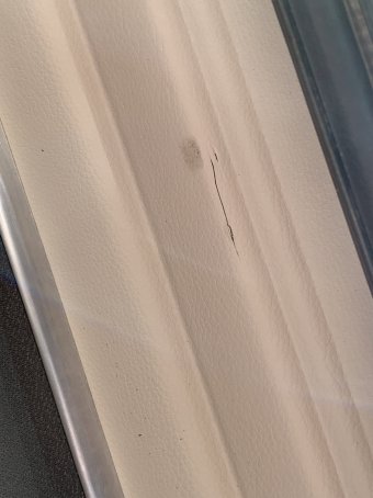

Just bare, but a textured finish.Hi, I had the blisters on the roof and Mercedes replaced it for me. Actually I thought they’d just re spray it. What I can’t remember though is if the inside had a lining or was just bare. The replacement is just bare. Anyone care to check theirs for me? Thanks
Does @Grand Tourismo ’s statement not hold true then?Found blisters on the roof of my Marco Polo, very disappointed. Not comforted by all the comments on here, only mention it to assist in people understanding this is likely to be more than the 5% mentioned. Only spotted it because I washed the vehicle myself. Not had it very long.
Had mine replaced at Blackpool Merc within warranty, tbh if its out of warranty I would not bother just a few little blisters who cares !Does @Grand Tourismo ’s statement not hold true then?
what’s the latest on this everyone? I’ve got a 2019 marco polo that is now out of MB warranty and I’m sure I have a couple of very small bumps/ blisters on the roof.
Are you serious? Why on earth should anyone put up with a defect such as this on a vehicle that costs so much.Had mine replaced at Blackpool Merc within warranty, tbh if its out of warranty I would not bother just a few little blisters who cares !
I completely with you on this , l mind MB UK has appalling after sales service , My 1st replacement had major bumps in it the day it was returned, there attitude was it fibre glass what do you expect, needless to say l rejected it immediately, my next roof blistered in the 1st frosts , just before my warranty ran out , that was reported Dec2021. Quite honestly l believe they are quite useless , l have to chase every 3 months and still waiting .Are you serious? Why on earth should anyone put up with a defect such as this on a vehicle that costs so much.
My roof was replaced a few months ago. The blisters were so bad that the paint was peeling in places. Do you really believe that is acceptable?
My new roof also has begun to blister and I’m now awaiting a second replacement.
