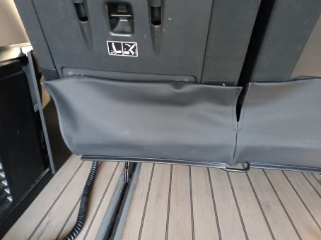

We had a lot of trouble finding it. Eventually our MB dealer showed us how to access it - and it's via the flap at the rear of the seats (ours is one of the first UK models). Do you have a nearby dealer who could show you?
does the flap come down? Mine has velco on both sides but the middle is completely stuck in place with something so I cannot see anything. Eventually I got to the switch from the seat side by putting my hand down the back of the seat. It was quite painful as I had to get my whole hand in right up to my wrist.

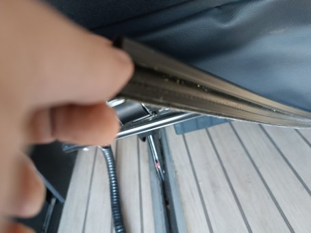

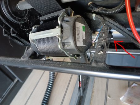

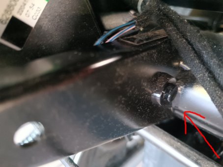

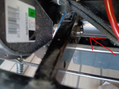

You click off the leather barrier and below it you will find the reset button.
