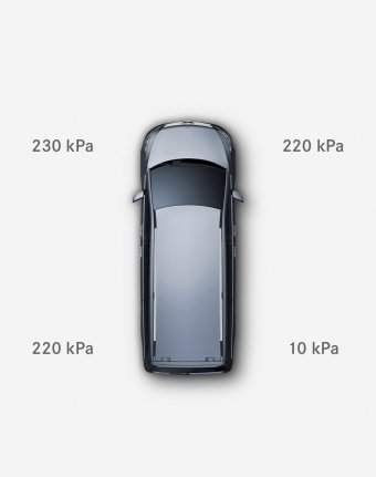

I had a little adventure last night. 30 miles in to my exit from Cornwall at about midnight the dash popped up the tyre defect warning whilst cruising at 70mph. The OSR was showing low, I thought it might just be low so keep an eye on it and see. The pressure was dropping rapidly so I backed off and checked the map for the next services. Fortunately just round the corner...

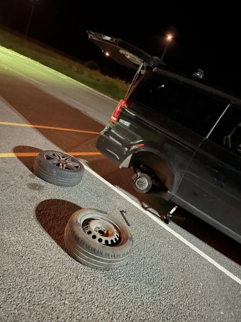

So I pulled over on at the Esso on Bodmin moor, jumped out and it was hissing quite loudly.. so I found a nice well lit spot to park and set about changing the wheel. I’ve not had to do this much in the past, just once I think on a Metro. Anyway it’s not a job anyone would choose to do, counting my blessings, it’s a warm and dry evening, the light is ok and I’m on good ground with a slight slope facing down hill but it’s the best I could get.
We carry chocks so my first job was to chock the front wheels, I dug out the tools, and set to work having to re-adjust the jack after I was so careful to make sure it was level.. the tool kit is great, it all worked well, no scraped knuckles, had some fun finding the access point to winch down the spare, I never read the hand book . But done-and-dusted in ~30min, with the flat back under.
A few things to note and the point of this post really.
1. remove the key from the ignition or at least put the handbrake on - I completely overlooked this and assumed the free play in the rear wheel was just how it is, never even thought to check as far as I was concerned the handbrake was on.
2. Be very carefull when opening the rear sliding doors, no issues here for me but I keep the wheel locking nut under the bed so had to get in the side to find it, tools can stick out..
3. When fitting the spare don’t use the locking wheel nut, use one of the standard nuts. This makes re-tightening the nuts with the short brace much easier and safer because the actual interface between tooling and nut is far more reliable.. I actually stood on the wheel brace to undo and tighten, then checked with my hands for a final time, a satisfying crack.

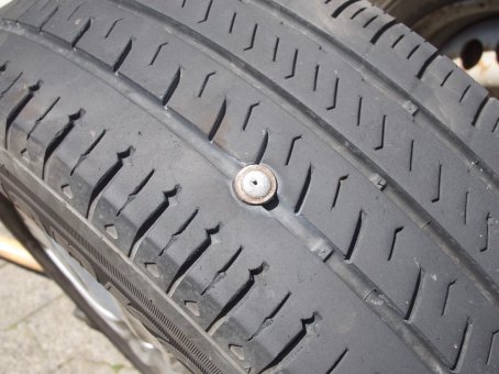

Only ever had to change a wheel at the road side once I can remember but twice now. Was doing about 135kph on a Autobahn in my T5 when I heard and felt a strange vibration/buzzing sound, thought it was where the Autobahn had changed from tarmac to concrete but felt very uneasy so slowed and pulled over in the next rest area.
I found the problem but could I break the seal between hub and wheel, tried kicking it with my heel, got out the camping mallet and set to work with that, but in the end it took the help of a massive German guy who came to assist with his equally large wife. He didn't speak English and my wife and I only a little German but when we had eventually removed the wheel he pointed at the hub and said "clean"
We found a tyre place and luckily was ok to fix. This was the offender:
