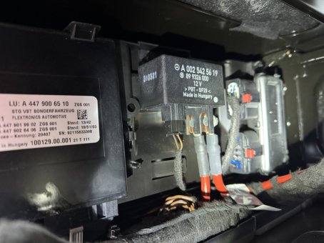

Here's photo of the K120. I had to fab a ground wire to attach the Orion XS to the van's ground (small gauge brown wires in the photo). The sensing wires on the K120 are not used.

Here's photo of the K120. I had to fab a ground wire to attach the Orion XS to the van's ground (small gauge brown wires in the photo). The sensing wires on the K120 are not used. View attachment 4132
