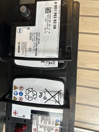

Dear All
Can anyone advise on the specifications of the Leisure battery in a 2018 Marco polo
Battery is located under passenger seat
Is there a part number available as I can’t locate it in my manual and MB aren’t that familiar with the vehicle configuration
Any / all advise welcomed
Details are on the battery itself. Very easy to replace I am sure there is a video on You Tune. Mercedes price is very reasonable.
