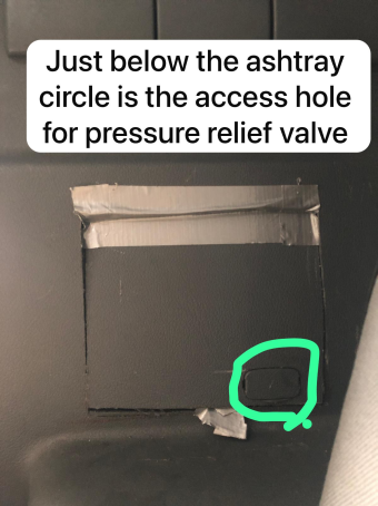

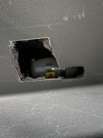

Hello! How did you remove the whole panel? I have the same problem in Italy :D :/(
Difficult but started from the rear ( where I found all the tools needed to change a flat) but you can just cut a hole around the hole were the manual pressure release valve is. I can send another picture if you need one.
It would be nice, cause i have the same problem! And enjoy Dolomites! It is where i live, in Bolzano!
but now i’m in Puglia with the van :)
Here are a couple of pictures. By the way. Be real careful not to drop the brass plug from the reservoir take. It’s a pressure seal. Always put a rag to stop it from falling to the bottomless pit below. The last time I didn’t and it’s gone so I had to “Mcgiver” one from some materials I had. The ducktape is a temporary fix till I get home.

I knew this would eventually fail for this 29 year old bus here is a picture of where I cut an ez access opening
