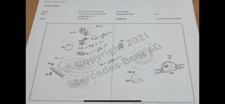

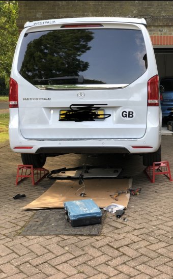

Hi, I had the same problem, but mine was imported from Germany as wanted a left hand Drive. When I got it back to England, I was furious when there was no spare wheel, no pump or the foam to fill into the tyre. I got a retro fixtures from a Mercedes Dealer in Dartford, who were reluctant to sell me this!! you'll just have to make a couple of holes in the back to hold the wheel, also you'll have to buy a steel wheel and tyre, which Mercedes were reluctant to sell!! I went to Norway in June and did 7500 miles, and a spare tyre, puts your mind at ease when you're miles away from a garage. I fitted it myself, though I had a friend help
