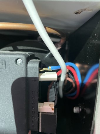

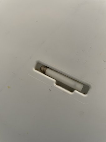

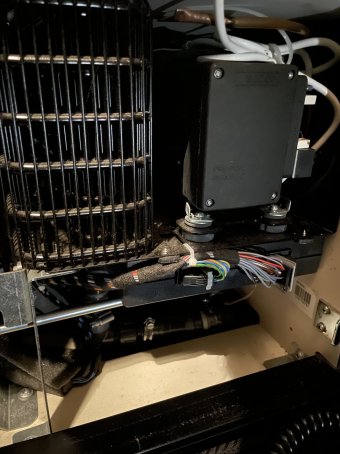

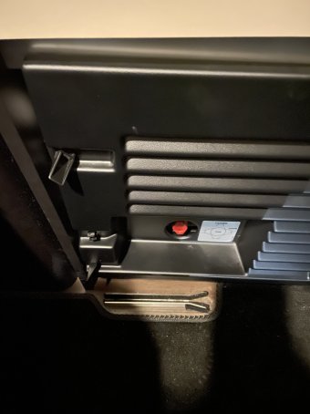

1. Open the cover pic 1. Inside you will see pic 2. The white wire leads from the thermistor which you will find inside the fridge sunk into its wall. (Pic 4)
2. lever out the thermistor gently with a flat bladed implement, I used a screwdriver tip.
3. Now use a torch and look at floor level towards the back of the opening on (pic2) on the right side and you should see a plastic (mine was white) wiring connector block with 6 wires going into either side, ( 2 are from the thermistor - the middle two in my case) the other 4 red, blue, brown, black lead to the fridge. You will find (by touch) that two sides of the connector block can be pressed inwards in order to release and split to two halves of the connector block (Fiddly but not difficult).
once this is released you can withdraw the top half of the block ( follow the route of the white thermistor wire to withdraw it and it should then exit near where the red and blue wires are shown in pic 3)

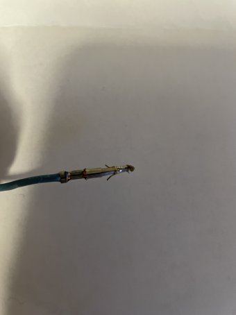

4.As I said, I have no special tools- you will see that the wires are secure in the block and cannot be released easily, this is because the ’bullet’ end is fixed in the block by ‘wings’ extending from its shaft (pic 5 - removed bullet end)
to remove this from the block I cut the thermistor wires from the rear of the block and pulled the bullet head the the front of the block using a small pair of fine pointed nosed pliers.

This is very helpful - my difficulty though is that I can't see the white connector block, which seems to be buried behind the compressor and the coiled up thermistor wire, and there doesn't seem to be enough room to get fingers in to reach to it. Did you have to disconnect everything at the front connector block first to get to it?. With a few months of warranty left I think I'll leave this to MB to fix even though I suspect the dealer won't be much the wiser. Will the new sensor last any longer than the original I wonder?
A
Andrew6586
Hi, I just managed to see the connector block with a torch at the back of the cupboard. I managed to separate it using one hand, pinching two sides together with my fingers. It’s quite a small space but accessible. Reassembly is quite simple as the block only fits one way so you can’t get it wrong. A little fiddly but possible. You can disconnect at the front if you wish (take a photo first) but I didn’t.
