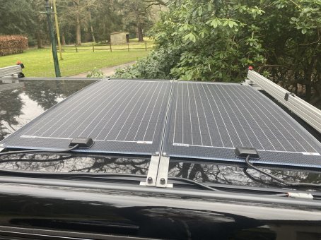

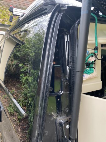

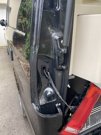

Hi @Apojapo, Hi folks, so sorry for the delay, been a bit manic at work. So I fitted two solar panels from https://www.solarcampersolutions.co.uk - really helpful chap, panels are working really well. My need for 240v is really only laptops. I am now looking at taking a fused connection from the aux battery but nothing heavy at all. If the community are interested. Also there is a great route for running the cable from the Solar Panel into the MP via the back light. Then! bought a Gibe Bus Tent, I have two say, its brilliant! it takes 5 mins to inflate with the manual pump. I hope everyone is able to start getting away and enjoying our lovely MPs! - We went to West Wittering today, parking for weekdays is only £2.00 but you need to do it via Just Park - do not pay anymore for weekday, weekends is £7.00 or £8.00. - Oh! last one, we added a CampLux Hot shower by removing the shower head from the Westfalia shower hose, so we now have a hot shower or just hot water. Sorry for the download but we cherish the MP and its been great to add tho water, solar, inflatable drive away awning etc.

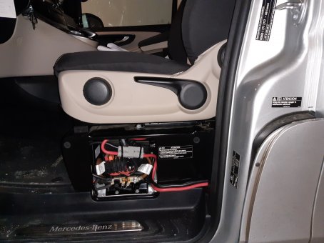

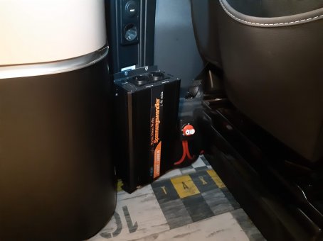

New member too. I have a 2017 Marco Polo and installed a 230VAC inverter a couple of years ago:
I installed the inverter between the driver seat (notice, it's an LHD van) and the sink because
  • Routing really thick wires to the leisure battery is a mess if the inverter is placed far away. Also, it's better to keep these cables as short as possible.
  • It can be easily removed if needed. The inverter is supported by two screws to an aluminum plate, and it can be removed without leaving visible holes.
  • We carry a small bin right in front of the inverter, so that corner was wasted space anyway.
I used a forklift battery connector and routed the cables as directly as possible:

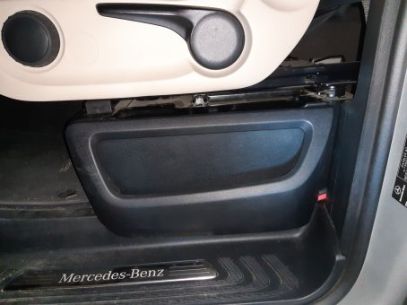

After removing a bit of plastic from the side cover to make room for the cables, these are not visible from outside except for a 1cm slit at the rear of the seat (see bottom right of the picture):
Quite happy so far. We disconnect the inverter when not in use, but often leave it on overnight charging laptop, cameras and drone batteries.
