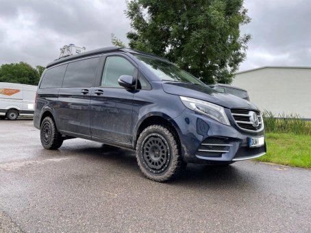

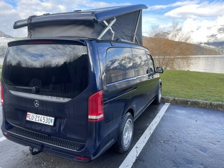

Here's a photo from a website that led me to discover the Twin-Monotube Projekt rims. My MP is the same color and these are black in the photo. With a beige interior and the AMG package I thought black was too dark and the Granite would look much better. Fingers crossed!
Mercedes-Benz-V-300_MarcoPolo_Hoeherlegung_AT-Raeder_Twin_Monotube_Projekt_AT-18_2.jpg
Expensive rims but probably worth it for the detachable protection ring.
Looks like that MP has had its suspenion lifted.
Yes, that one has a lift. This is from terranger.de
I have AirMatic on my 300d and can lift as well, but the issue with AirMatic is above 30 Km/h it drops back to standard ride height. There is no way to keep it lifted. The other thing is my mechanic claims that there is also no way for me to change to VB or Goldschmidt Air suspension as I already have AirMatic. So I don't have many options anymore for modifying the suspension. I've contacted several after market companies that already sell recoding mods for other models of MB's with AirMatic to lower ride height to see if they can come up with something. Those kits have been around for years but AirMatic on a V Class is very new and only an option from May 2021 from what I can tell.

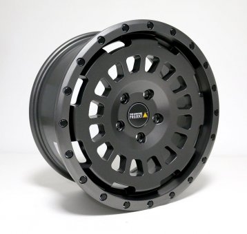

The price is actually ok for forged wheels that only weigh 13 kg's per corner. I'll be saving about 40-50 kg's of unsprung weight total vs the stock 19 inch AMG's. The only options I've found for off road style wheels that are homologated and legal are:
- Black Rhino Sandstorm in 17 or 18 inch
- Steel wheels in 17 inch
- Hess H53's in 18 inch
- Twin Monotube Projekt in 17 or 18 inch
After a lot of research it's better to get the 17 inch to have more tire options that will fit.
