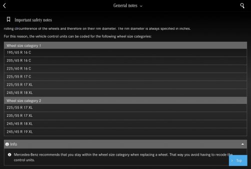

Just be careful swapping wheels and tyres. As the photo in the post above shows you cannot swap between wheel size categories without having to have modules recoded. I assume this can only be carried out by dealers or someone with the correct tools ie STAR.
Gone are boy-racer days and “just” worrying about the effect on the speedometer and flaring wheel arches.
Nowadays the “computer” knows all.
At best it could invalidate warranty and at worst invalidate insurance.

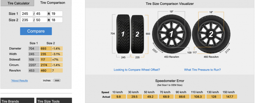

I was just proposed these tires by Hess Automobile in Switzerland as a good option with their 18 inch wheels as A/T's won't fit without a suspension lift of 30mm. They also told me that it might not even be possible for me to change the suspension to the VB Air Suspension as I already have the Mercedes AirMatic Air Suspension from the factory. Damn...
Tires: Cooper WSC Winter 235/50 R18
I then called my Mercedes Service Center and they told me these should be fine. I also checked using a tire size calculator comparison and this is acceptable. Not an A/T tire but as close as I'll get with a Winter tire. I'm not convinced these are acceptable though as it appears the load rating is not the minimum 102. Haven't decided yet though. ;-)
