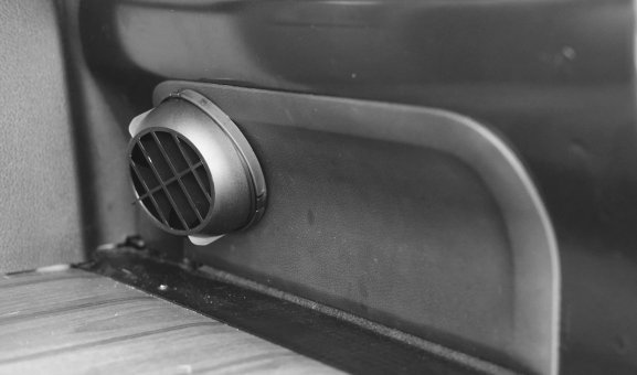

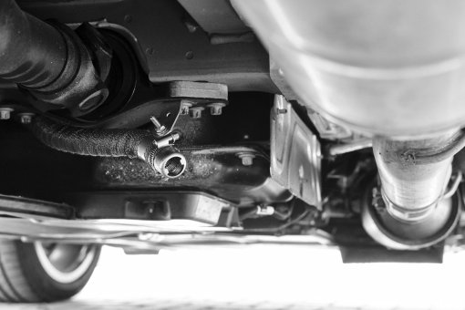

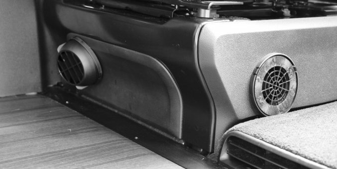

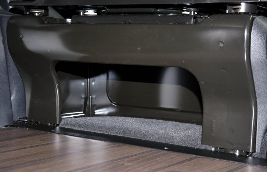

No phone call from Leon in the morning so headed off anyway and got there about 10:00. The MP was still on the ramp, seat, seat box and fuel tank on the floor. Seems my MP has the larger Adblue tank that had complicated things so I had to kick my heels for a few more hours. eventually at 3:00 I got the call. They had to fit extra titanium heat wrap and insulate the tank due to the closeness of the exhaust. I was quoted £1500 and although it took 1/2 a day longer than expected I paid £1531.71, the extra being for the insulation.

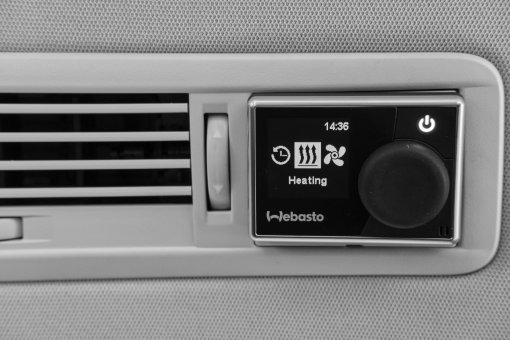

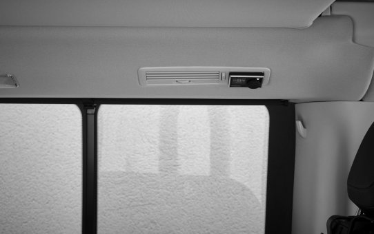

I highly recommend anyone who wants to retro fit a heater to check out Tim Purslow, they have fitted many Webasto heaters. Previously they used Eberspacher heaters but found the control/thermostat units unreliable. If they were closer to me I certainly use them for servicing rather than a main dealer.
