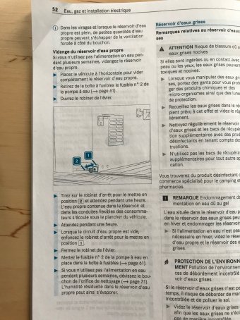

Hi everyone. I had a similar frustration when draining the fresh water tank on my Marco. As I didn't want to mess with the wiring I looked for another solution. You may want to try:
Plugging in the shower but do not switch on and don't attach the shower head.
or leave the filler cap off whilst draining.
These should enable the fresh tank to drain.
