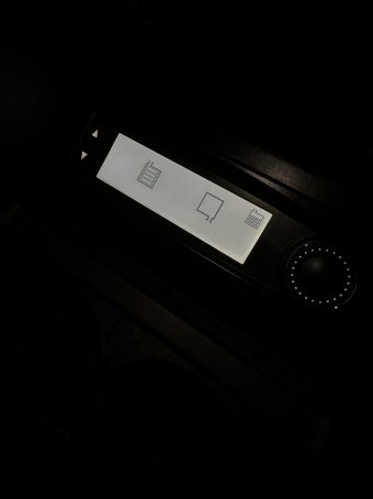

My Marco Polo’s water tank level indicator isn’t telling me my water tank is full. What could be causing this? A faulty fuse?
Hi - it is showing fresh water full, left side display and the bars are hollow. The right is waste and has solid black bars when full, yours shows empty. Looks like its all OK.
