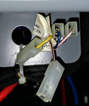

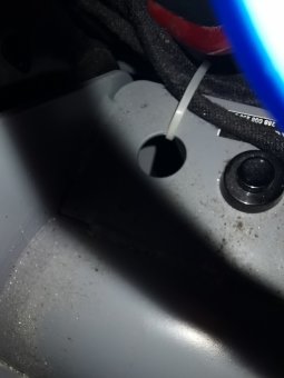

Thank you so much. My seat was slightly different, but it inspired me to go back for another hour where I finally found this reset button. Seems a deliberately hard to find switch, designed to get owners back to MB workshops (?). Anyway, thank you so much for your swift response.

I am glad you found it.
Yours is an important post because it shows the location of the reset button for an earlier model which as far as I know has not been posted on this forum.
None is easy to find.but, given the comments on Mercedes dealers I doubt they would be any better.
For the sake of completeness I will put the other location on this thread so that they are all in one place.
