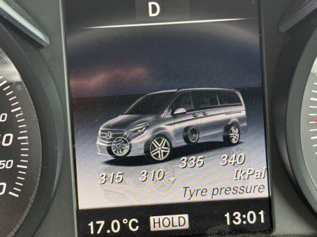

They used schrader valves btw so they are branded.
Can anyone change these units to Bar? I can’t see an option on the instrument cluster.
