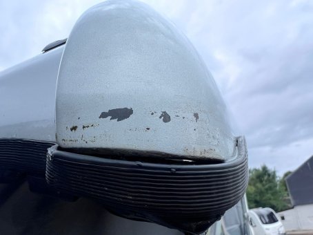

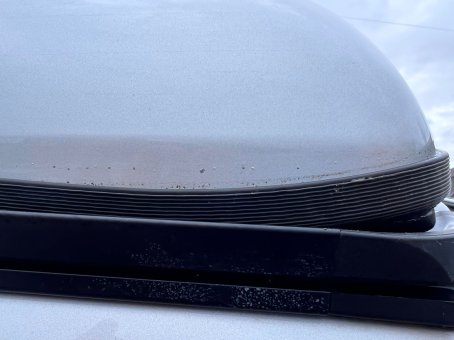

Thought we had found the vehicle for us on Friday but after a few phone calls and a video and pics it soon transpired that the roof had the dreaded blisters and being a late 2019 MP obviously out of manufacturers warranty.
So can you offer help to me please with the following questions…
1) Will Mercedes UK offer any warranty or goodwill solution on a 4/5 year old MP with a blistered roof (taking into account it arguably should be covered the bodywork corrosion warranty?)
2) Has there been any success with a specialised body-shop repairing / repainting the roof to offer a aftermarket solution?
3) Would a professional vinyl wrap be a possible solution to cover the blisters and ‘seal in’ any further issues? Basically wrap the whole roof sealing it in the process…?
4) Am I missing anything else?
What I don’t want to do is spend my £50/60k on a MP only to face a potential big bill X months down the line. There is no other campervan we are considering but this issue isn’t helping.
These are pics of the vehicle we thought was the one - is this the blistering issue in question? The dealer selling it had no idea and had never heard of the issue before.
Thanks in advance, Chris

I have a 2018 registered version just about to have a replacement roof fitted. I think that once osmosis has set in, there's not so much you can do to repair composites other than grinding out the affected areas and filling with epoxy before repainting. This is what's done on composite hulls of yachts and boats. I, too, have wondered about wrapping - in this case, of a new roof. However, I think the material has to be slightly porous to allow fitting (unless I am mistaken), which means that deposits of the hydrophilic resin within the lay-up will still be exposed to ambient moisture.

Our roof had blisters all over the top surface of the roof as if it has some bad disease, ranging from 3mm dia to 10m dia or bigger. Those in your picture look like they follow the edge of the rubber seal so they don't replicate ours or other pictures that we have seen. Has that roof been resprayed perhaps to hide the problem?
Nobody ever offered an explanation as to the cause but MB replaced it within warranty period and it then happened on the replacement roof just out of warranty and they replaced that too. The longer it's out of warranty the less likely they are to do for free. My argument would be that a roof should last the life of the vehicle. If a body panel corroded after 5 years then that wouldn't be acceptable so how can a known and ongoing roof fault possibly be acceptable. Keeping a close eye the current roof. I think MD understands the repetitional risk.

You might find it worth reading my posts, both on this page and page 28. The roof issue is due to the dates of roofs produced. Current ones are ’hopefully’ okay. Dealers turn a blind eye to the real cause and I only won my case when I wrote to the MB CEO. All info contained above
Its only a few blisters live with it, they don't pop if mine came back out of warranty I would not be that bothered sorting as as they are very difficult to see
I only got my roof replaced as it was in warranty !
Them images are not a blister issue may I add, something more sinister that
