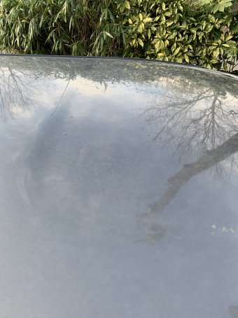

Tiny blisters on roof

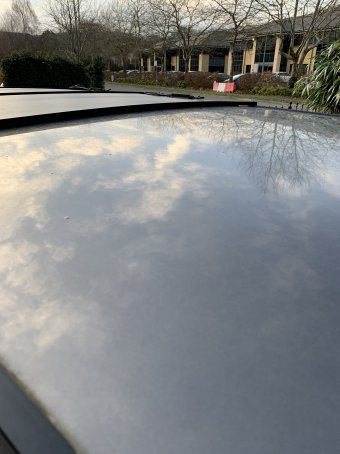

The dreaded blisters have returned! And this time much worse than before. Another visit to MB Cardiff tomorrow!! I am convinced it is due to the very cold weather as I’m sure they were not there last week!

My blisters were always noticed after the frosts , l am waiting for dealership to come back with a reply from technical dept at MB , as MB head office at Milton Keynes denied there was a problem with manufacturing process of roofs ,despite me now requiring a 3 rd roof . I know another owner who has raised a complaint . Perhaps we all need to do this , as once out of 3 yr warranty they won’t have to replace

Unfortunately the current cold weather might bring more blister to light.

Totally agree with you, mine has just been back for investigation as was worse than ever and the service manager agreed and asked me do I think it is connected with the cold weather! So looks like a second roof for me with 6 months of warranty left! Worrying if it happens again.

That's why I am still trying to decide whether it's worth my while to report the returned blisters on my second roof. There is no guarantee that it won't happen again. In fact anecdotal evidence shows that they haven't solved the basic problem and blisters will appear again sooner or later. How many roofs are you prepared to go through.

It would be interesting to get a report from a paint/fibreglass specialist to further understand what causes the blisters...is it a paint issue caused by a reaction/application failure or maybe frost as others have said...
