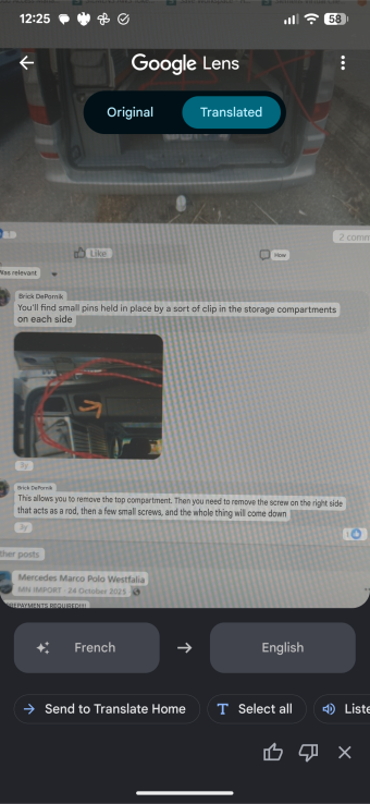

Anyone that have done upgrade of rear speakers in the Westfalia interior, the ones sitting in a consol above the back door. How to get access and what to remove? Any hints apreciated.
Hi, I'm just pondering the same problem. Did you get anywhere with working out how to remove the overhead storage locker to get access to the rear speakers?
