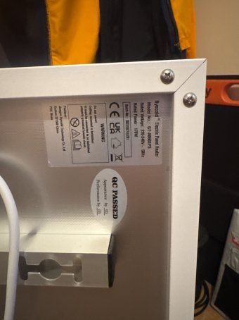

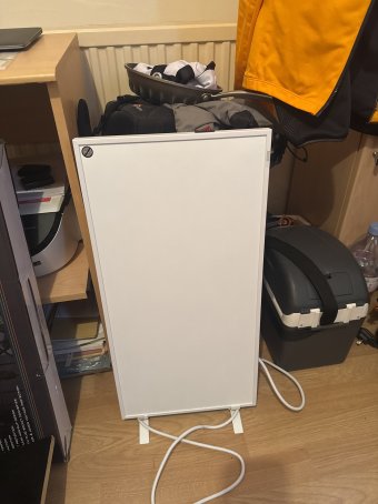

Hi Halsall, May I ask two questions? First, can you show a photo or let me know a specific location of getting the cable through the tailgate without being crushed? Second, regarding the infrared radiator, what is the wattage on its label and can you share the brand and model? Many thanks for your advice.We bit thr bullet and bought the Jackery 1000 and two 100w Jackery solar panels. We put the panels on top of the awning roof. The battery we plug into the outside socket of the van and feed the cable through the rear tailgate. The cable does not get crushed when the tailgate closes. The battery they acts like you are running with mains connected. We also run an infrared radiator to heat the inside of the van. It only consumes 100w/hr, The rad sites between the two front seats. The rad has a thermostat, so overnight the battery drops to about 50%. The two solar panels then top the battery up very quickly during the day. But you can also charge the Jackery battery through the cigarette lighter cable that comes with the battery. We tend to only stop at one site for 2 days max, so the setup works really well.
Hello sorry for the late reply, we have just been on the Wild Atlantic Way in Ireland. We ran our setup on the trip, you can either run the cable through the tailgate or through the rear quarter. This trip we went through the rear quarter window as we placed the battery on that side of the van. We put it that side so we could also charge the battery from the cigarette lighter socket in the rear of the van. Plus we also ran the cable from the jackery solar panels through the side window. I will go and tske a picture of the infrared radiatorHi Halsall, May I ask two questions? First, can you show a photo or let me know a specific location of getting the cable through the tailgate without being crushed? Second, regarding the infrared radiator, what is the wattage on its label and can you share the brand and model? Many thanks for your advice.

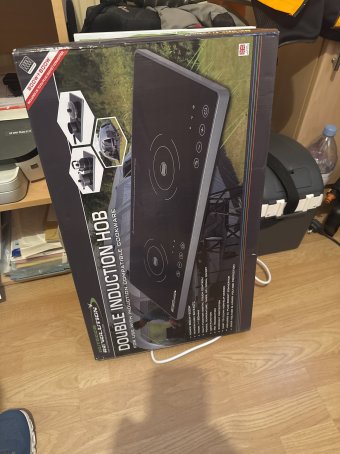

See attached pictures, this time we tool a camping induction hob, which we ran from the battery as well. We have a jackery 1000, which you can also monitor reportly. We leave a wifi dongle in the van which allows to turn the heating on off remotely…Hello sorry for the late reply, we have just been on the Wild Atlantic Way in Ireland. We ran our setup on the trip, you can either run the cable through the tailgate or through the rear quarter. This trip we went through the rear quarter window as we placed the battery on that side of the van. We put it that side so we could also charge the battery from the cigarette lighter socket in the rear of the van. Plus we also ran the cable from the jackery solar panels through the side window. I will go and tske a picture of the infrared radiator
Thank you so much for the helpful information and ideas. When I saw infrared heater I was assuming it radiates the red glow and wondered how it was like at night time. Apparently this one doesn't glow. Is this radiator sufficient for a winter night? I am about to install a diesel overnight heater for my 2017 Marco Polo and I still have a few days to look for options. Do you think I can use this instead of modifying my van? Many thanks for your thoughts.
