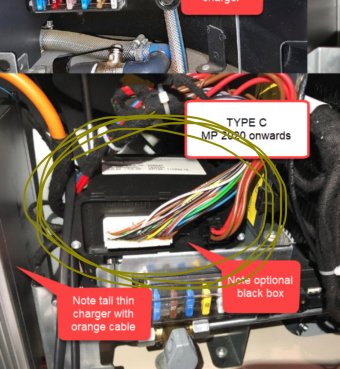

it’s probably regulator fail. Today i expect deliver used regulator for replacement (New are not available) If it help i wll let you know. If not, service man from MB promised me share the diagrams. ( they have only connection diagrams) Once got it i will share with you.
Thnx for updating me!
Regulator is located under the fridge - hiden behind the black panel locked by 2 screws on the left side. Before open this panel you must remove seat wiring from the connnector near fusevox. Controller is located on top of fuse box.

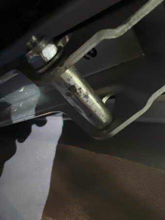

I have the same problem. Switches working properly, but LCD shows, "OPEN" :-( Did you find a diagram / some solution?
Thnx
You must regulate left and right sleeves - set as low as possible - if it’s too high is not able to push microswitch and then MBAC shows popup roof OPEN . I had the same lroblem - I did it and problem despaired.. Good luck - let me know if it helped
