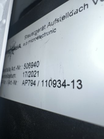

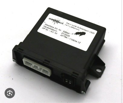

I have the same problem. Switches working properly, but LCD shows, "OPEN" :-( Did you find a diagram / some solution?Thnak you for advice. I ‘ve already check that out. I have disconnected wires on connector and it seems both microswitches are working properly :-(. But i’ve noticed there’s short circuit on left wires between black steering box and the connector. Maybe it’s the reason of problems. Now i am looking for diagram of wiring between black box connector and microswitch to check out if the cable is damaged. Does anybody on group got diagrams for wiring or schem of connector pluged into black box (ap794/110934-13)
