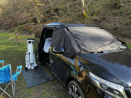

My 2017 MP Sport pop up roof failed this weekend, after taking my son for our first trip together.
This was the sequence of events
Please help.
Suggestions welcome, before the inevitable trip to Mercedes (but I really don't trust their experience in the Camper side).
Thanks.
Dane
- Leisure battery fully charged (12.9 V)
- Roof raised fine when first set up to camp
- came back to van ready for bed (beds set up etc) and Westfalia console continuously beeped with Roof Up error
- Roof would not lower in the normal way (battery voltage ok).
- Switched on ignition, 2 tone beep was heard.
- Locked van and came back 10 mins later - continuous beep still going.
- Lowered the roof in the Emergency way, switch under the cooker and lowered bit by bit.
- Alarm stopped sounding and no errors seen.
- The next day I tried to roof again and immediately the alarm sounded again, so closed the roof.
- Plugged the van into the mains, and the beep started again (with the Westfalia screen showing the plug)
- The next day tried the roof (not plugged in and 12.5V) and it would not move.
