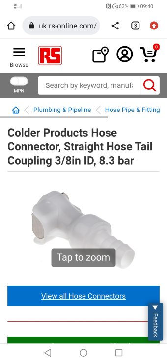

Its not a standard domestic shower connection and the trigger on the head is useful, but you can buy the connector part from RS components. I was lucky, bought mine from a person on here who sold their MP. It is quite useful.
I guess this is what your asking?

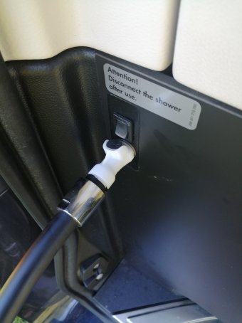

I bought this connector and a cheap 10mm hose from argos, just in case it didn't work but works perfectly. No leaks etc, works as you'd expect.
Connector pushes on
Screw other end on
The original connector was missing but had the hose and shower head.

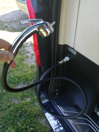

The hose from argos was £4 and good thick quality. When I cut off the MP hose, I was truly shocked how thin and poor quality it was compared to £4 argos hose.
It's long enough to be attached to the tailgate window and I shower 2/3 times a week after diving.
Remember it's the inner measurement of the hose not outer.

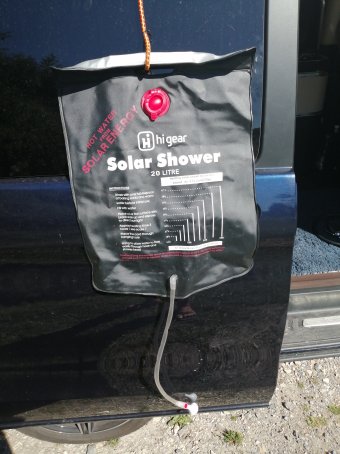

The bag is perfect if your parked up, I've had a quick shower this morning.
Water warm in 2 hours, only in summer though

I couldn’t remove the fixing on the original hose, so bought a cheap one from Argos. Any hose will fit with correct measurement.
I think it was a 10mm both ends just screw on.
Easiest way take the shower head and try in store, if that fits it will attach to the connector
