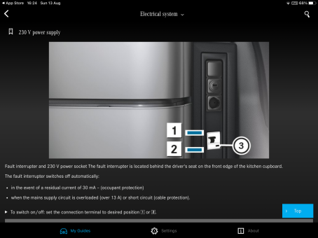

Ours charges when driving but plugging it into shore power seemingly drains the leisure battery. What and where is the "ELCB button?" My search of the electronic user manual found no mention of ELCB button.
Hi KDM
Earth Leakage Circuit Breaker. Item 3 in the manual picture. Provides protection on mains sockets when on hook up as in a domestic electrical supply
UP is ON and, if the test button is pressed or knocked while travelling ( been there done that !) it will trip to OFF and the mains socket wont work and the batteries wont charge even if the van is connected to an external mains supply.
Hi KDM
Bless You! That was it. Flipped the switch up, checked the leisure package display panel and it shows a plug and the bars are showing that it's charging. Thank you so much. I'll remember to check after carwashes as we have no kids, dogs don't have opposable digits, but the carwash boys have gotten me previously when they accidently flipped the kitchen faucet on (with no water in the tank).

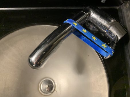

Regarding stopping the tap/faucet being knocked on and potentially burning out the water pump motor if no water in the tank: I always have a stout rubber band ( the sort of wrist band they sometimes give out at events etc. ) This ensures the tap is always held closed but it is still easy to operate the tap against the rubber band to turn it on.
