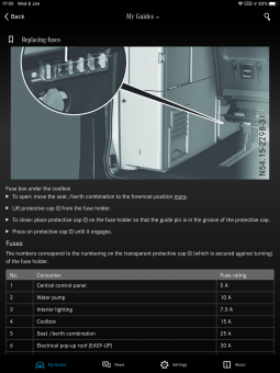

I’ve just emptied my water tanks and removed the 10amp fuse to protect the water pump.
I will just carry a couple of 5 litre bottles of water in the fridge for any short winter trips.

is the fuse for the water pump on the kitchen unit ? im assuming it would be there?
