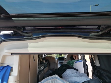

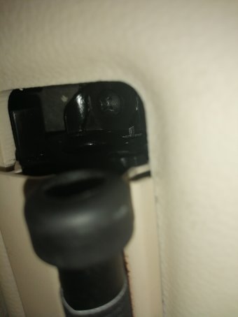

1. Remove the blind by taking off the end caps and unscrewing the 2 grub screws.
2. Remove the door seal low enough to work around.
3. Remove plastic surround, stiff but gently tease it out.

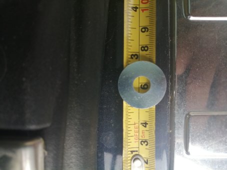

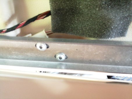

4. 4 hinge bolts, one at a time unscrew and add Washers to the other side - between metal strip and hinge. I used 4 on each bolt to create a large enough gap to allow the latch to engage better.
I used 20mm with 8mm centre.
5. Once all 4 bolts are done, check the gap and door closes, adjust by
adding / removing Washers.

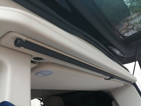

6. Replace plastic surround and door seal, the seal has 2 gaps to fit the door frame and the surround.
7. Reattach the blind.
Job done.
