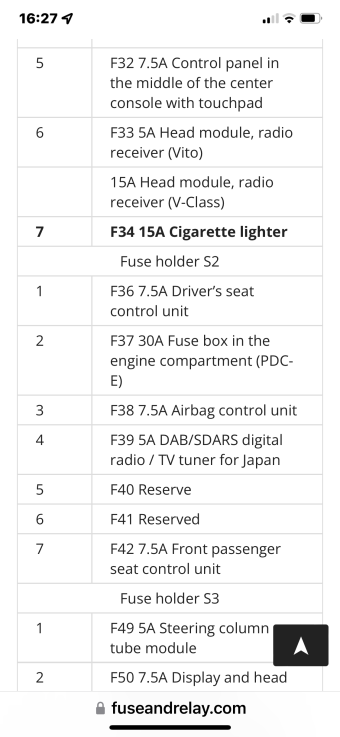

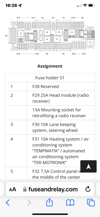

As another by the way... I seem also to have noticed that the 12V DC cigarette lighter socket in the centre console at the front isn't working, does anyone have a fuse layout to allow me to track down the fuse and swap it out?
NOt sure if i am looking at the right on line fuse guide but according to this, bank S1 fuse 7 is the “cigarette lighter”. Having a look at mine (footwell of passenger seat) there is no 15A fuse present.
Should I pop a new 15a fuse? I mean what’s the worst that can happen eh?
