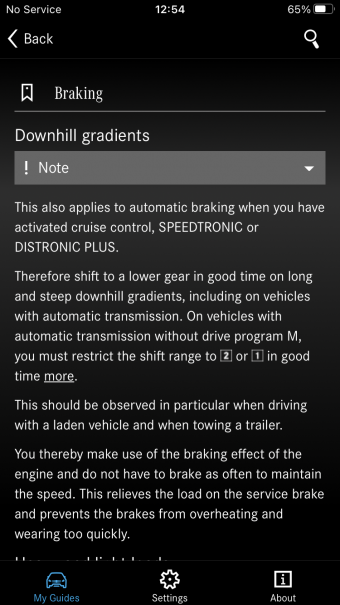

The manual suggests you drop into the manual flappy paddle mode and use M1 or M2 (as enclosed) to relieve the stain on the brake system, especially when towing heavy loads.

Interesting that the manual says its best not to stop after a particularly heavy session as cooling the brakes in moving air is preferable than stopping.
