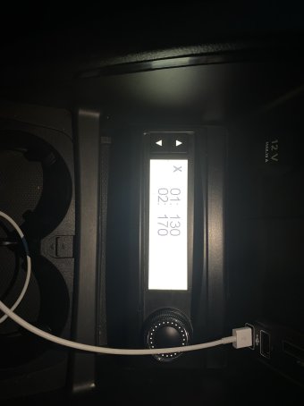

I found on trawling this site for knowledge, short cuts and hints and tips that there is a hidden menu in the central control panel.
it’s accessible by pressing both up and down arrows together for a few seconds.
first option up lists out error codes on the unit. second gives access to heater and third some sort of spanner which I presume means maintenance.
does anyone have a list of those error codes at all? I’ve wasted a good hour or two trying all sorts of different search terms but to no avail.
I drained my water tank recently my and of course the water empty error was displayed therefore I’m assuming that the first error code on the list (130) probably relates to that, the only other error on the list was 170 however as there is no time stamp I’ve no clue as to what that may have related to. No other errors are present and it looks like there are slots for the most recent 20 error codes.
I have deleted the log to determine if these will reappear.
Note, these are not the same as MB system errors these are errors associated with the Westfalia roof, fridge, heater if installed and water etc.
