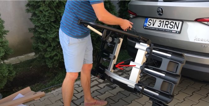

When the rack is open, bikes at 45deg, what is the rack resting on ? On the Thule 934100 EasyFold XT, 3 Bikes, 13 pin there is a rubber plug in the steel tube. Removing that plug gets you a few extra cm of swing on the rack, enough to clear the hatch... Worth a try maybe ? Try looking at the end of the tube with the red arrow on it...
