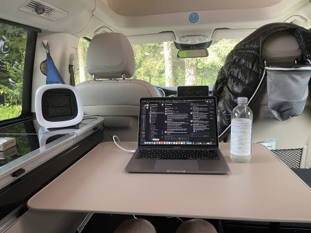

2) Some places I stay have lots of flying bugs and creatures that love entering the MP. I've ordered a Reimo mosquito net for the side door, but it has yet to arrive. I've been leaving the doors and windows closed for now, with the exception of the kitchen sliding window as I have the Westphalia metal venting cover. On hot days it still starts cooking inside the MP so I hunted for a MicroClima device I could use to cool the air without the motor running. I bought the EvaPolar EvaChill and it works quite well! Also powered by USB and simply add water from the tap. Can reduce temps by about 5C.

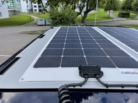

4) I didn't want to be tethered to landline power cables unless absolutely no other option. I installed 320 watts of solar with Votronic controller, charger and bluetooth module. The install does not require any holes in the roof and uses an almost flat mounting plate that simply bolts to both roof rails. Awesome! Charges the leisure battery and also my EcoFlow Delta from an added 20A 12V socket I installed in the terminal strip that is always on (no motor running). Electricity situation sorted.

I'm looking to a way of charging my leasure batterry when the vehicule is parked. Solar and AC (camping) would be a solution. Havve you encountered issues with the solar panels?

Hi tutuxico, no issues at all so far and it's been great! The biggest issue you'll have over the winter is slower charge rates due to the lack of sun vs summer, but that is to be expected. I had my kit installed at CaliSolar which is close to me, but from Vaud you'll need to make a day trip out of it.
He's just added some new products as well like a new LiPo4 Leisure battery which provides double the run time with half the weight. It's pricey and I haven't had the need for more power myself, but nice to see he keeps adding more for the MP to his product line. Ask for Reto if you call or write for more info.
