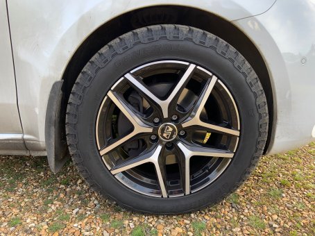

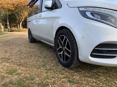

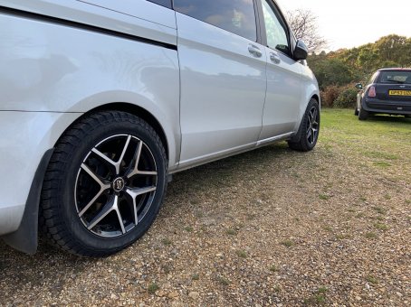

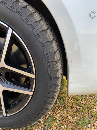

Ive done it.. 235 x 55 x 18 General Grabber ATs3 as complete package supplied by Rogue alloys. A bit close on the front but not touching on full locks ( it does look very close though) thats one compromise... Wheels/Tyres look stunning (MSWs) the ride is perfect/quiet too just fiddling with tyre pessures - great for what we do tramping down Autoroutes going up/down gravely pot hole roads/wet grass/towing overweight trailers with very overweight AMG MP 250d -with all obvious additions on board. I will report back after the second compromise.... changeing the tyre pressure sensors over from my last ones... thats a real pain, but.. an MOT failure! These tyres have a great load rating with good strong walls, these vehicles need that if your putting them to work as designed.. Pics on very dirty van (sorry). - This has been tricky as to get ATs on an MP as sizing is crucial, hopefully helps some people, good value too?

NB Im Still testing the above as there is very little room Lock to lock on front... I will revert with my opinion, ie are they good enough to put up with a little touching.. I hope so.
Epigram
Well done for being a guinea pig.
As you say, good sidewalls are a must if you want to get off the beaten track.
Do the tyres actually touch and how are you for clearance with suspension travel?
