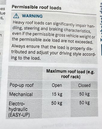

Could anyone one kindly tell me how much weight I can have on the roof with it open/up, as I kayak and need to use the van with the roof up, but do not want to take the boat/s off roof to use the living space… one of the kayaks weighs 18 kg…?
as I am currently looking to replace my T6 VW for a Marco Polo I need some guidance as this is a grey area from the dealership side.. any help would be very much appreciated, regards Ellie.
