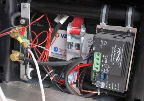

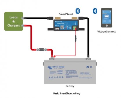

I'm going to fit a shunt and was wondering if anyone knows if it would be ok to simply replace this with the shunt? I've not seen a connector block like this before.
I'm not sure what the small white & black wires are or why they're connected like that, but they need to be connected together with the other cables on the load/system side of the shunt.

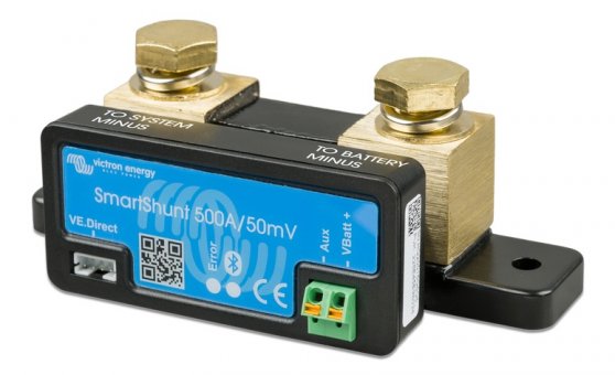

This is the Shunt:
This is the Shunt:
