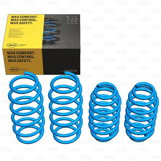

Our MP came with the optional sport suspension (supposedly slightly lower and stiffer) and we were bottoming too frequently. We also had to replace cracked rear bump stops.
We've just replaced our springs with reinforced MAD springs ( https://mad-suspensionsystems.com/en/products/reinforced-main-springs/ ) and the difference is massive. The van no longer seems to float on linked tight turns, and I don't think we've hit our bump stops again.
