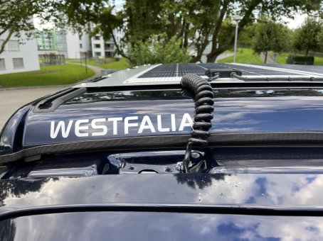

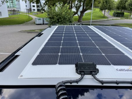

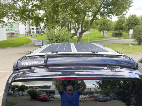

I installed mine in Switzerland and it looks like you are in Cambridge. Here's some photo's nonetheless! These are 160 watt panels so 320 watts total. The baseplate is mounted on the rails of the roof so no drilling at all. And the wire runs through where the hinge is located so no drilling there either. Overall I have been very pleased. Work was done by http://www.calisolar.ch
View attachment 2033View attachment 2034View attachment 2035
HELLO WEBBACH, is it possible to send me a picture how and where you inserted the solar cables trough the roof ?? This is my problem. As far as I can see out of your pictures its gone trough the Hinge , but where ?? and where are you coming inside of the car out with your cables ??? Prfect Job !!!!
Hi there,
I can do that as soon as I have my MP back. It's in service now getting the roof replaced (finally) after waiting 4 months. The cable is routed through the rubber boot and the installer made a small hole to do that. It then routes through the headliner and behind the cabinets to the front cabinet. The solar charger, etc, are mounted inside the cabinet just below the upper drawer where you put utensils. It has just enough clearance to do that and still use the cabinets without issue. Really clean install and I'm super pleased with it!
