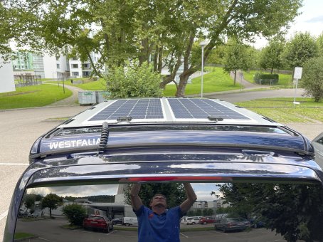

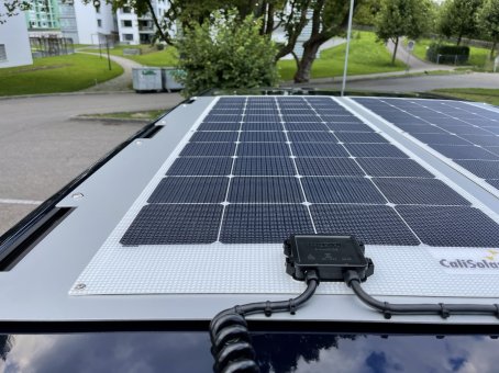

I posted this in the other thread but here are some photos of mine. No drilling at all. Base plate mounts to rails and wire goes through where the hinge is in the rear.

I had this done by a professional. I live in Switzerland though. I had mine done at http://calisolar.ch
I don’t believe Mercedes will help you. There are numerous places in the UK to get this done.
The baseplate under the solar panels probably does double duty as insulation, but doesn't the space below get clogged with leafs, dirt, sand and whatnot?
No issues at all with any debris. My concern was if there would be any wind noise as there is the small gap front to back but this also hasn't happened. I assume the wind blowing through the bottom clears the debris and also keeps the panels cool. On a perfect day I've been getting ~300 watts which is great.

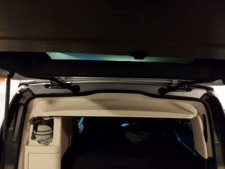

Hi, thank you very much for your pictures. Please can you send also pictures when the hitch is open ???? I am really querious about where you insert the cables to go into the chassis. Is this trough the rubber cable isolation beneath the hinge, or goes these realy trough the hinge.
I am looking forward to your replay ???

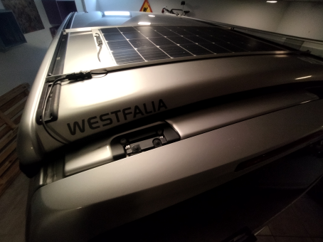

I have stuck mine to the roof with a good quality double sided adhesive tape. It's not going anywhere, I can highly recommend it. It's been on for two or three years now.
I was warned by friends that I should not do the whole perimeter of the panels, as a few strategically placed smaller pieces of tape will be sufficient. But I couldn't resist, worried that it wouldn't stick. I quickly learned how amazing the 3M VHB tapes are.

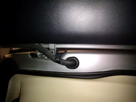

Like above…bring the wire in around the hinge and then into the loom rubber boot…from there to your controller (usually in the top cupboard by the back door)… good luck
Ok, thanks. But I am not sure how to get through the rubber without cutting or damaging anything. I am planning to get this one:

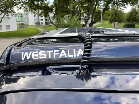

In case it helps someone, my solar panel cable goes like this:
Then it enters the rubber cable hose right next to the left hinge - I had to make a small cut, and then protect it with tape.
It is almost unnoticeable with the door open:

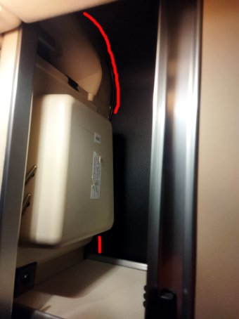

After that, the cable enters the rearmost cupboard, and goes down following the corner -- next to the red line in the pic. The cable is black and hard to see:
From there, the cable goes forward towards the fridge. I have installed the solar charger in the space under the fridge, it fits nicely next to the AC-DC charger.

OK great. Thanks a lot. So it seems like there is no way around damaging the rubber tube with a cut :-((
No big deal. The solar cable is quite thin. If for some reason you decide to remove the solar panel, you might even be able to fix the cut in the tube with bicycle tyre glue.
