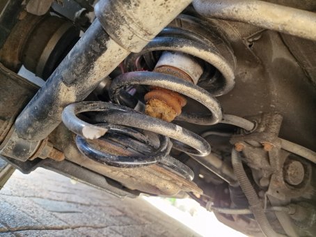

One of the rear springs on my 2017 MP has broken off at the bottom (last coil and a bit), and I'm trying to source replacements. Mercedes tell me that it's on a long back order (none in the UK or Germany), and that the part number is A447 324 07 00 .. I asked them for any details on the length or wire diameter and they couldn't provide any details other than it was a one green stipe spring. They also couldn't tell me if the part number was shared across other models of V-Class, Vito etc.
I've tried searching online for it, and it doesn't seem to be very commonly listed, or available compared to springs I've replaced on other cars. Has anyone replaced the rear springs with a non-OEM spring, and if so any details on part number or where you bought it would be greatly appreciated!

I discovered this morning that both the rear springs on my 2017 220 Sport MP are broken and, like you found, have been told replacements are on back order. Did you get anywhere finding suitable alternatives?

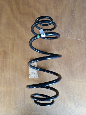

Happy days, the springs landed in last Thursday and I fitted them over the weekend. New springs were about 15mm shorter than the ones fitted, but everything looks OK after fitting them.
The overall length is 410mm, ID is 140 mid-section with 15mm OD wire, and 80mm ID at each end with 10mm wire (~7 coils total). The Eibach springs listed are quite a bit shorter than this so I guess that I don't have sports suspension!

Currently it looks like part no A4473240700 (1 green bar) appear to be generally in stock in the UK - see https://www.oemstar.co.uk/part/A4473240700 for example - but they are still out of stock on main sites in Germany though - including the official MB parts site, so may not be available for long here if past experience is anything to go by.
From 21st Nov I will have a pair of lightly used alternative rear springs available as an emergency 'get you on the road' option if anyone is interested at some point in the future should the correct parts go out of stock. These are part no: A4473241204 - see my notes above re my experience.
