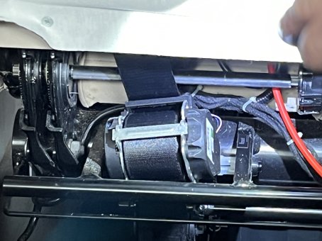

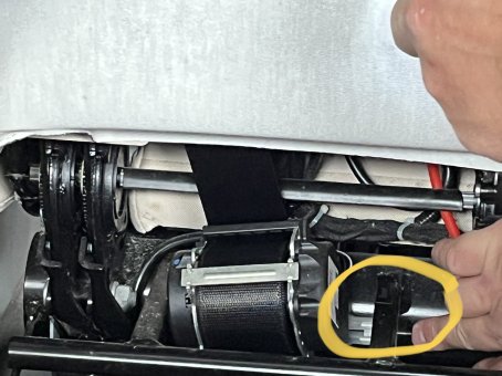

I have a 2019 MP and one of the rear seats is only able to be inclined using the RESET procedure. So after having the seats in the flat bed layout, it takes me about 40 mins to incline the seat. The other seat works well. Has anyone had a similar experience? There is a control box within the seat with a Westfalia part no., but Mercedes do not recognise it because it’s not on their stock system. Mercedes have three controller box options but cannot match it to the Westfalia part. If I buy one and it isn’t right I have to pay 60% of unit cost. They are all expensive parts between - £500-£800!
If anyone has any suggestions I would be grateful.
