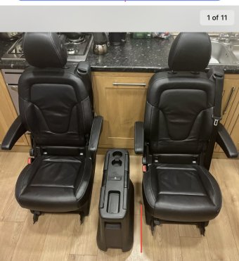

New horizon owner looking to purchase two extra seats to make it a seven seater and looking for mattresses recommendations
I’m looking to get two extra seats and would welcome comments on where to look to purchase and I’m after lower mattress recommendations for the lower bed. Many thanks James
If is your Horizon 5seater from factory, You have to also instal 4 additional sliding brackets inside rails where You can mount the extra seats, better to ask your MB dealer
It’s a bit tricky this one. The seats shouldn’t be a problem as long as you find seats from the same model number.. all the fixings/runners are at least in my 18 model fitted however, the centre console/folding table fist to a different type of double rail that came from the factory install.. I have researched the table as I was looking to install it myself, I think you’ll need to replace both the centre rails with the comparable ones that come with the console.
