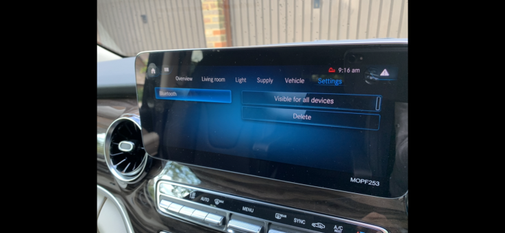

Hi all. Trying to connect the MBAC app to our new 2021 Marco Polo. I don’t get the same screen showing on the MBUX system that the app says I should get, and it won’t connect. Has anybody else managed to connect to a very new 2021 model (May build)? When I go into the MBAC screen on MBUX and go to settings in the MBAC option, I get the screen shown in the photo attached. I have put in a support request with MB but wondered if anybody else has the same problem.

This is the area I found very tricky - getting the mobile to handshake with the car's bluetooth.
You need to touch the screen at "visible for all devices." The elongated square "turns on" by moving from a dark blue to a lighter blue.
Now that needs to stay on. Keep your eye on this when following instructions on your phone because it tended to disconnect frequently and that may be the nub of your difficulty. Can you give more info re stage you are having difficulty?

Thanks for the reply. I did see the other thread and kept turning the Bluetooth back on when the blue square went off, but it still didn’t connect. I kept getting a message in the app saying to enter the code displayed on the MBUX screen, but there was no code on the screen. It appears I have the later version in MBAC on my MP and that doesn’t use the VIN, it uses code pairing. Out of interest, what phone have you paired? I’m trying to connect an iPhone.
All sorted. I reset the MBUX system, deleted all Bluetooth connections to the MP in my phone and then followed the instruction as posted in the images by Marc O Polo above. The problem is you get a message on your phone saying to enter the pin displayed on the MBUX screen, and there isn’t anything displayed. This is where you have to enter the last six digits of your VIN. You then get a new screen on your phone where you enter the last 8 digits of your VIN.
