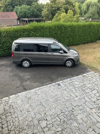

Does anybody know what is the name (technical) of my Marcopolo color
a. And what is the color code? So that in case of local deep paint scratch repair I can do it DIY?
b. what kind of primer I may use before the small paint.
Photo is attached herewith, color is in non technical eye, deep brown from 2016

It may not be any help as you are based in Belgium but I used a UK company called PaintNuts to buy a touch up paint.
Their website allowed me to input my car registration and it confirmed the correct paint code to use.
Maybe you have something similar in your country.
If not your local MB dealer should be able to help.

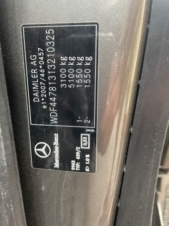

Thank you so much for your guidance….. Found it on the driver side door , code is 9963 and also found a very similar site who may deliver the touch up paint , color name is “Indium grey met”. Thanks again.
