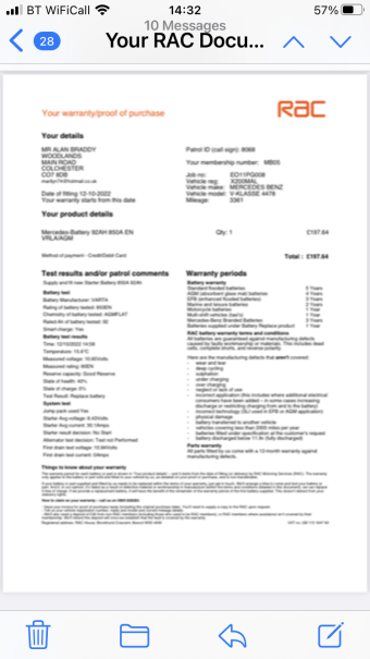

Hi Phil, we had a problem with our battery & our MP was only a few months old. The battery was completely spent & we couldn’t even unlock the door!
We had Mercedes RAC out to check things & they replaced the battery and said that we needed to drive it for 20 minutes every 2 weeks, never heard anything about this before. We have been able to claim the money back under warranty even though we were told that we couldn’t.
Also told to buy a trickle down charger and to keep it plugged in all the time, bit difficult it you park at an airport for a decent holiday

Hi, I don’t have a receipt as such, as they paid directly into my account! I hope that you can get everything sorted as it spoils the experience
I got a refund from Mercedes CH for 75% of the value of the van. It's what's they call purchase price. I could have sold it for much more but I just wanted to get rid of it. Never again Mercedes! Bought a CUPRA Formentor and love it.
