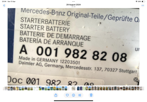

This is what we have. We asked the dealer if there should have been a different battery for the leisure (auxiliary). We were told “Mercedes fitted the same for both”. However many people here have fitted Lithium. The starter battery is expensive as it’s supporting stop and go. Therefore I’d take advice. I know also there maybe changes in the charge relays to allow the alternator to charge Lithium.

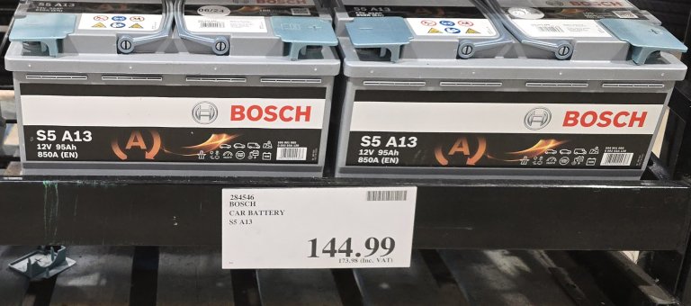

Seems after further digging on here that maybe a different battery should be used. Even though shows as good have to say we do have occasional issues with roof, seats and fridge. All seems to point to battery not holding charge. I’ve been pointed to this as an appropriate replacement
Or this AGM version
I have replaced both Starter and Leisure batteries with two of these from Costco, all is working OK.
