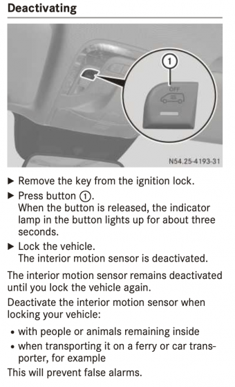

Hi Igor and welcome to the forum.
If you are talking about setting off the alarm while sleeping, just make sure you lock the door via the interior (door) lock button. Otherwise try this...

The overhead button
OK so what exactly are you trying to achieve? If it is just about not setting off the alarm while sleeping, make sure you use the door lock and not the key fob. If it is something else, maybe pets? then post some more details: what year, model etc
