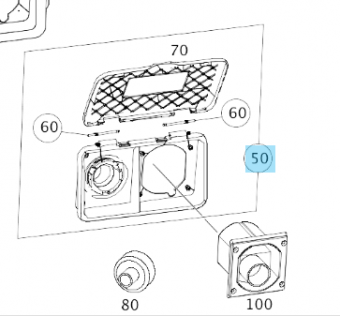

Hi all one of the pins on my MP has come out at some point, does anyone know where I can get another pin please,JM.
According to my local MB parts department, the pins and springs can’t be ordered separately. Ridiculous really, so the complete unit (50) was replaced uder warranty. The replacement part was even painted the same colour as the van.
